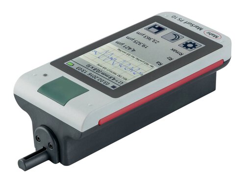

Product features "SMAHRT Surf" – simple, smart and mobile
  • Compact roughness measuring instrument for mobile use
  • Simple and intuitive to use: as easy as using a smart phone
  • Large, illuminated 4.3" TFT touch display
  • Adjustable display
  • Data backup as TXT, X3P, CSV or PDF file
  • Create complete PDF measuring records directly in the measuring instrument
  • Customized comments for the PDF measuring record can be entered directly into the MarSurf PS 10
  • Mains-independent operation: Over 1200 measurements without having to recharge the instrument
  • An all-in-one solution. Small and lightweight (approx. 500 g)

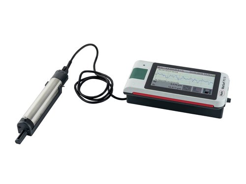

  • Instrument flexibility: removable drive unit
  • 31 surface parameters: offer the same range of functions as a laboratory instrument
  • Roughness standard stored within housing aids in reducing errors
  • Quick access to your frequently used functions via the Favorites list in the display
  • Automatic cutoff selection, so even non-specialists can be sure of getting the correct measuring results

Scope of delivery Raunormal, im Gehäuse integriert (herausnehmbar), Tasterschutz / Prismenhalter, power source, instruction manual, Tragetasche mit Schulterriemen, USB cable, Verlängerungskabel zum Vorschubgerät (Länge 1,2 m)
