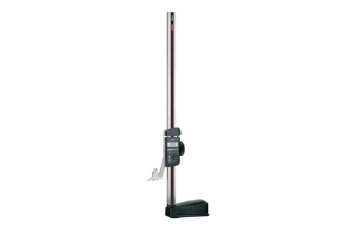

Digital height gage Digimar 814 SR
| Product number: | 4426101 |
Height measuring and scribing instrument Digimar 814 SR
Measuring range : 0 - 600 mm
0.01 mm / 0.0005 inch
Error limit µm: 50 µm
Data interface: Opto RS-232C, Digimatic, USB
Package contains: scriber, battery, test certificate, instruction manual, carton
1.400,00 €
Functions
RESET (set display to zero), mm/inch, ABS (switch between relative and absolute measurement), Lock/Unlock, PRESET (for entering a numerical value), DATA (data transmission via connection cable), AUTO-ON / OFF
- Scribing and marking of work pieces
- Measuring heights and distances
- Interchangeable measuring and scriber tips, carbide-tipped
- Convenient hand wheel for positioning and measuring
- Fine adjustment device with locking screw
- Ergonomic and sturdy machine base
- Hardened and lapped contact surface for smooth and even movement
- Slide and rail are made of hardened stainless steel
- High contrast 12 mm LCD display
- Data output: USB, Opto RS232, Digimatic
- Battery life up to 3 years
Package contains
Digimar 814 SR | Art. no. 4426101
a 62 mm | b 180 mm | c 35 mm | d 835 mm
