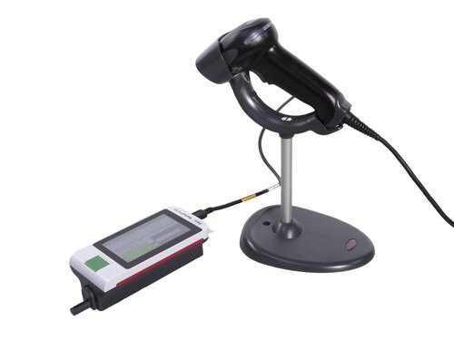

- Connection of a scanner for automatic start of the measuring programs or reading of protocol texts via barcode or QR code
