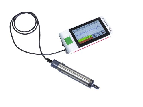

Mobile roughness measuring instrument MarSurf M 310
Product number: 6910265
The all-rounder with 5 µm probe tip
3.435,00 €
Variants
5,60 €
Please enter the label
  • For shafts and housing components
  • For large machines
  • For large workpieces
  • For milled and turned parts
  • For ground and honed workpieces
  • On the production line or directly on the machine; ideal for rapid testing of the surface roughness of a workpiece
Product features Mobile roughness measurement – guaranteed success!
  • Compact roughness measuring instrument for mobile use
  • Simple and intuitive to use: as easy as using a smartphone
  • Large, illuminated 4.3" TFT touch display
  • Adjustable display
  • Micro USB interface for remote control using ASCII commands, e.g. using software for statistical process control
  • USB-A interface - for connection of e.g. a USB Wwreless adapter or the USB/wireless printer
  • Wireless transmission of measurement results via wireless stick to the free MarCom software
  • Remote start of measurement via cable or wireless
  • Connection of a scanner for automatic start of the measuring programs or reading of protocol texts via barcode or QR code
  • Specification of the intersection line C in μm or in % of Rz for the parameters Rmr and tp
  • Data backup as TXT, X3P, CSV or PDF file
  • Transfer of measuring records and data optionally via cable or wireless
  • IATF 16949 compliant – safe traceability with MarConnect
  • Print directly on mobile printer (as option or directly in set with printer)
  • Create complete PDF measuring records directly in the measuring instrument
  • Customer-specific comments for the PDF measuring record can be entered directly into MarSurf M 310
  • Display and printout of the MRC and ADC diagram
  • Storage of measuring programs (quick & easy)
  • Mains-independent operation: Over 1200 measurements without having to recharge the instrument
  • An all-in-one solution. Small and lightweight (approx. 500 g)
  • Instrument flexibility: removable drive unit
  • 31 thread parameters: offer the same range of functions as a laboratory instrument.
  • Roughness standard stored within housing aids in reducing errors
  • Quick access to your frequently used functions via the Favorites list in the display
  • Automatic cutoff selection, so even non-specialists can be sure of getting the correct measuring results
  • Additional versions with transverse drive unit available as MarSurf M 310 C2 or MarSurf M 310 set without probe
  • Free software "MarWin Easy Roughness Viewer" for further documentation (statisics, multiple profiles and results on one page etc.) available for download on the Mahr website.
