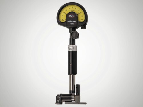

Self-centering dial bore gage Marameter 844 NB
| Product number: | 4474179 |
Measuring range 20 - 50 mm mm
Design: For blind bores. Moveable anvil and stationary anvil carbide-tipped
Package contains: measuring holder, measuring head, anvil spindle, wooden case, excludes indicator
1.095,00 €
- Measuring head consists of a carbide tipped moving anvil and an interchangeable stationary anvil with a carbide ball
- Transmission lever system transfers movement of movable anvil to indicating instrument
- The broad centering bridge ensures automatic centering in the bore
- Resistant to temperature because the shank and transfer rod are made of heat resistant Invar steel
- Highly resistant to wear and tear because of carbide tipped moving anvil
- Constant measuring force due to built-in spring, eliminating user influence
- Universally applicable and extremely versatile
- Each instrument spans a broad measuring range
- Quick and easy to adjust to any size (within its range) - Invar steel has a particularly low expansion coefficient
- instrument totally insensitive to any kind of heat (including user body heat and increased ambient temperature)
Marameter 844 NB | Art. no. 4474179
a 1.5 mm | b 10 mm | c 77 mm | d 60 mm | e 163 mm |
