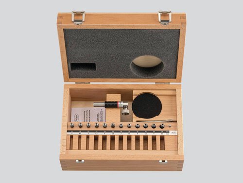

Package contains: Measuring holder 844 Kg, probe, expanding pin, wooden case, excludes indicator

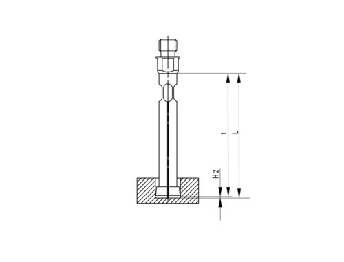

Model for Blind Holes
- For measurments near to the bottom of bores
- For indicating measurment of diameter and testing for roundness and conicity of bores
- Especially suitable for testing batches
- Determine the reversal point by rocking in the bore
- Measuring head made of hardened steel, hard chrome plated
- Extensive modular system is composed of measuring head, transfer needle, holder, depth extension, right angle attachments and setting rings
The minimum set of a measuring instrument consists of: Measuring head, transfer needle and holder plus indicator unit
