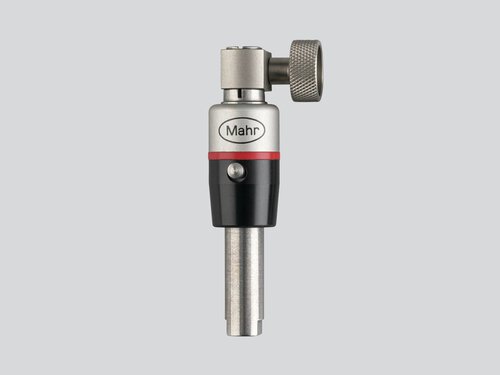

Holder for indicator Marameter 844 Kga
| Product number: | 4473401 |
844 Kga Holder for indicator
L = 73 mm
Connection thread g: M6 x 0.75
Mounting hole: 8 mm
L = 73 mm
Mounting hole: 8 mm
267,00 €
Type 844 Kga: Special design with retracting button, for easier insertion of the internal measuring probe into bores.
Recommended for small and sensitive bores.
Type 844 Kgz: Special design for dial gages with shaft diameter 3/8 inch (typical for dial gages from USA).
- Holder for mounting an indicator (comparator, dial gage or inductive probe) and connection of an 844 K/KC/KS inside measuring probe or corresponding accessories such as 844 Kt measuring depth extensions or 844 Kw right angle attachment
Marameter 844 Kga | Art. no. 4473401
d1 10 mm | l 23 mm |
