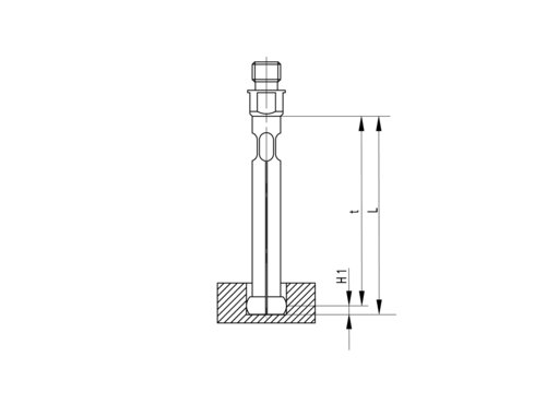

- For indicating measurement of diameter and testing for roundness and conicity of bores
- Especially suitable for testing batches
- Determine the reversal point by rocking in the bore
- Measuring head made in harden steel, DLC coated
- Extensive modular system is composed of measuring head, transfer needle, holder, depth extension, right angle attachments and setting rings
Benefits of DLC Coating
- DLC = Diamond-Like Carbon
- Extremely high wear resistance, for long service life even on hard or abrasive surfaces
- Reduction of friction, ideal for sensitive surfaces such as non-ferrous metals and aluminium alloys
- Wear indicator, worn areas appear as bright spots in the dark DLC coating
