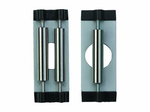

  • For determining the pitch diameter of external threads by the three-wire method
  • In conjunction with outside micrometers, indicating measuring instruments or measuring machines
  • Each pair consists of one holder with 1 pin gage and one holder with 2 pin gages
  • Holder has a satin chrome finish, the retainer ring can be locked yet the rotating spindle can still rotate
  • Pin gages are hardened and lapped. Freely floating in holder to allow proper positioning and contact with thread flanks
  • Manufacturing tolerance ± 0.5 ?m
  • Mounting bore 6.35 mm = 1/4", 8 mm on request)
  • For threads with outer diameter up to 95 mm
