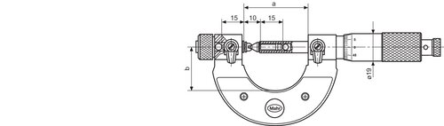

For measuring pitch and outside diameters of external threads with interchangeable screw thread measuring anvils
DIN 863-3
Measuring range : 125 - 150 mm mm
Readings: 0.01
Package contains: case
DIN 863-3
Readings: 0.01
0,00 €
- Scales have a satin chrome finish
- Rugged steel frame, heat insulated
- Spindle is hardened throughout, ground and provided with a locking device
- Adjustable anvil
- Spindle and anvil both have a mounting bore to accommodate interchangeable anvils
- Flat end surface of the anvil shank rests on a hardened steel ball at the bottom of the mounting bore
Package contains
case
Micromar 40 Z | Art. no. 4170035
a 170 mm | b 83 mm |
