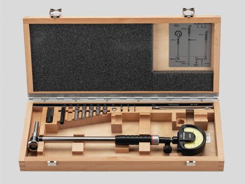

Self-centering dial bore gage Marameter 844 N
Product number: 4474003KAL
Measuring range 250 - 400 mm mm
Design: Standard, moveable anvil carbide-tipped
Package contains: measuring holder, measuring head, anvil spindle, wooden case, excludes indicator

  • Measuring the diameter, roundness and conical form of a bore as well as the distances of parallel plane surfaces
  • Measuring head consists of a carbide tipped moving anvil and an interchangeable stationary anvil with a hardened steel ball
  • Transmission lever system transfers movement of movable anvil to indicating instrument
  • The broad centering bridge ensures automatic centering in the bore
  • Resistant to temperature because the shank and transfer rod are made of heat resistant Invar steel
  • Highly resistant to wear and tear because of carbide tipped moving anvil
  • Constant measuring force due to built-in spring, eliminating user influence
  • Universally applicable and extremely versatile
    - Each instrument spans a broad measuring range
    - Quick and easy to adjust to any size (within its range)
  • Extensive modular system is composed of measuring head, holder, extensions, right angle attachments and depth stops
  • Invar steel has a particularly low expansion coefficient
    - instrument totally insensitive to any kind of heat (including user body heat and increased ambient temperature)
Package contains measuring holder, measuring head, anvil spindle, wooden case, excludes indicator
