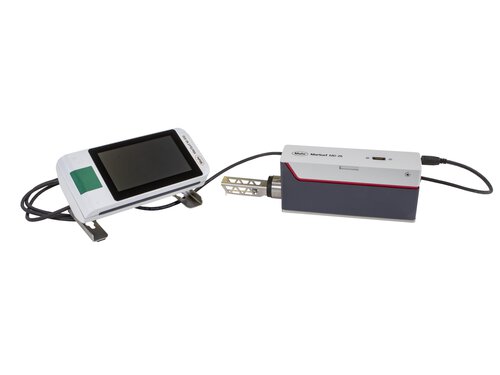

Simple, innovative, flexible – modern surface metrology for handheld use
- Handy roughness tester for mobile use
- Simple and intuitive operation: As easy as operating a smartphone
- Large, backlit 4.3“ TFT touch display
- Rotatable display
- Magnetic probe holder: Fast probe arm change without tools
- Thanks to skidless probe: measurements of roughness as well as waviness – no extra measuring station required, determination of R, W and P parameters
- Simple alignment of the probe system: The inclination can be easily corrected using the menu-guided graphic instructions./li>
- Process and material safety thanks to automatic zeroing
- Micro USB interface for remote control via ASCII commands, e.g. via software for statistical process control
- USB-A interface for connecting e.g. a USB wireless adapter or the USB wireless printer
- Wireless transmission of measurement results via wireless stick to the free MarCom software
- Remote start of measurement via cable or wireless
- Connection of a scanner for automatic start of the measuring programs or reading of protocol texts via barcode or QR code
- Specification of the profile section lebel C in μm or in % of Rz for the characteristic values Rmr and tp/li>
- Data backup as TXT, X3P, CSV and PDF file
- Transmission of measurement protocols and data optionally via cable or wireless
- IATF 16949 compliant - secure traceability with MarConnect.
- Print directly to the mobile printer (as an option or directly in the set with printer)
- Creation of finished PDF protocols directly in the measuring device
- Customer-specific comments for the PDF log are entered directly on the MarSurf M 410
- MRK and ADK curve display and printing
- Measuring programs are saved (Quick & Easy)
- Mains-independent operation: over 1200 measurements without having to recharge the device
- Everything in the palm of your hand. Small size and low weight (approx. 500 g)
- Flexible device: Removable drive unit
- More than 50 parameters: Offer a performance range like a laboratory instrument.
- Quick access to your desired functions through favorites storage in the display
- Automatic cutoff selection: ensures correct measurement results even for the non-measuring technician
- Free software "MarWin Easy Roughness Viewer" for further documentation (statistics, multiple profiles and results on one page etc.) available for download on the Mahr website.
Package contains
- MarSurf M 410 operating unit
- Drive unit MD 26
- 1 standard probe arm BFW A 10-45-2/90°, standardized
- Docking station for operating unit
- Probe protection
- Built-in rechargeable battery
- Charger / 3 mains adapters
- Height adjustment (integrated)
- USB cable
- Extension cable for drive unit (length 1.2 m)
- Operating instructions
