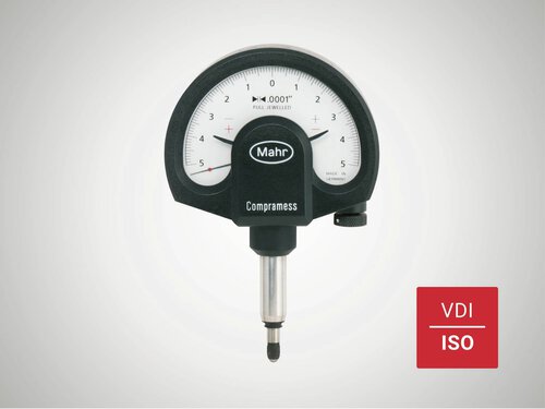

Mechanical dial comparator Millimess 1004 Z
Product number: 4333900KAL
Dial comparator Millimess 1004 Z
Factory standard
Measuring range : ± .0050"
Graduation value inch: .0001''
Package contains: adapter bush 940, 8 mm to 3/8", test certificate, case
266,80 €
Variants
Add service
Test interval
Place of use
Please enter the place of use
5,60 €
Please enter the label
  • Large, high contrast dial face
  • Adjustable tolerance markers
  • Lockable fine adjustment screw
  • Shockproof movement
  • Mounting shank and measuring spindle are both made of hardened stainless steel
  • Measuring spindle is mounted in a high precision ball guide for minimal hysteresis
  • Resistant to lateral forces (side play) acting on the measuring spindle
  • Maximum sensitivity and accuracy are ensured by the jeweled movement in conjunction with the precision gears and pinions
  • Box type protective housing
  • Constant measuring force
  • Measuring spindle can be retracted with either a screw in cable release or with a lifting knob
Scope of delivery adapter bush 940, 8 mm to 3/8", test certificate, case
Millimess 1004 Z | Art. no. 4333900KAL
