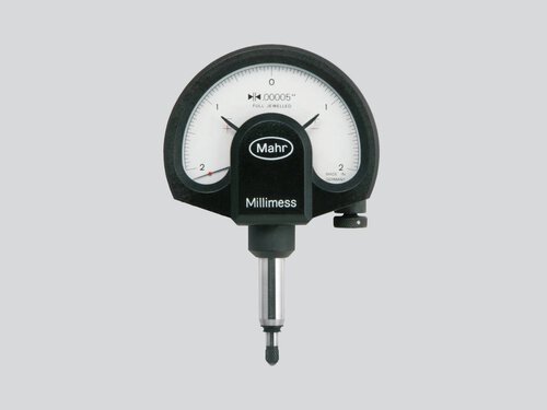

Mechanical dial comparator Millimess 1002 Z
Product number: | 4335900 |
Dial comparator Millimess 1002 Z
Factory standard
Measuring range : ± .0010"
Graduation value inch: .00002''
Package contains: adapter bush 940, 8 mm to 3/8", test certificate, case
Factory standard
440,00 €
- Large, high contrast dial face
- Lockable fine adjustment screw
- Shockproof movement
- Measuring spindle is mounted in a high precision ball guide for minimal hysteresis
- Resistant to lateral forces (side play) acting on the measuring spindle
- Maximum sensitivity and accuracy are ensured by the jeweled movement in conjunction with the precision gears and pinions
- Box type protective housing
- Constant measuring force
- Measuring spindle can be retracted with either a screw in cable release or with a lifting knob
Scope of delivery
Millimess 1002 Z | Art. no. 4335900
