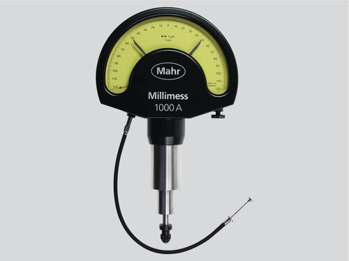

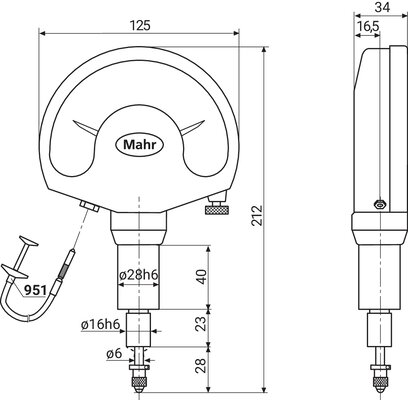

Mechanical dial comparator Millimess 1000 A
Product number: | 4338100 |
Dial comparator Millimess 1000 A
Factory standard
Dial color: Yellow
Measuring range : ± 120 µm
Readings (µm): 1 µm
Measuring force: 3.5 N
Package contains: cable release, test certificate, case
Factory standard
Dial color: Yellow
Readings (µm): 1 µm
741,00 €
- Very clear, reliable and fatigue-free readings due to extra-large display.
- Ideal for test stations at which high volume production parts are measured or where the display can only be read from a distance.
- For use in a stable measuring table. We recommend: MarStand 824 GT measuring table
- M2.5 thread on end of measuring pin for optional standard anvils
- Large, high contrast dial face
- Lockable fine adjustment screw
- Shockproof movement
- Measuring spindle is mounted in a high precision ball guide for minimal hysteresis
- Resistant to lateral forces (side play) acting on the measuring spindle
- Maximum sensitivity and accuracy are ensured by the jeweled movement in conjunction with the precision gears and pinions
- Box type protective housing
- Constant measuring force
- Measuring spindle can be retracted with either a screw in cable release or with a lifting knob
Scope of delivery
