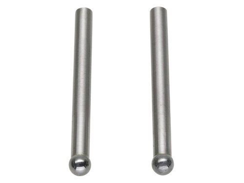

844 To Measuring Anvils, Ball diameter 6 mm , Adjustment range 20 - 40 mm
138,50 €
  • For measuring front groves on inside and outside diameters
  • For inner diameter with retracted boring bar
  • Universal applications
  • With cylindrical holding shaft for fixing in 844 Tma, 844 Tmi, 844 Tms mounting attachments
  • Can be moved in the mounting attachment for setting the measuring depth
  • With spherical probe surface for inner and outer measurements
  • Made of hardened steel
