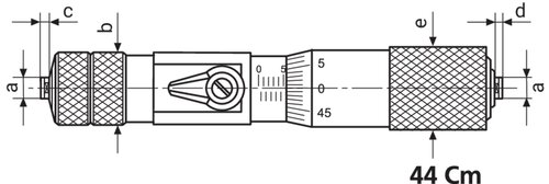

For measuring inside diameters and distance dimensions, as well as use as a adjutstable gage for setting parallel distances
DIN 863-4
Measuring range : 100 - 500 mm mm
Readings: 0.01
Package contains: caseMeasuring head 44 Cm, measuring range of 100-150 mm with extensions 44 Cv, case
DIN 863-4
Readings: 0.01
885,00 €
- Rigid, lightweight tubular construction
- Locking device
- Carbide tipped spherical measuring faces
- Interchangeable extension 44 Cv contains cylindrical gage rods that are spring mounted in protective sleeves for the extension of the measuring range
- Protection sleeves have a satin chrome finish
Package contains
Micromar 44 Cms 3 | Art. no. 4168022
a 5 mm | b 16 mm | c 2 mm | d 2 mm | e 18 mm |
