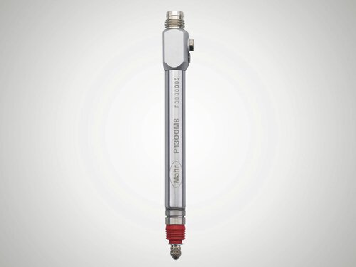

Inductive probe Millimar P1300 TB without cable
Product number: | 4400193 |
Compatibility: Tesa
Measuring range : ± 2 mm
Compressed air retraction (max. 1 bar)
Measuring force: Depending upon air pressure
Package contains: test certificate, instruction manual, spanner for preliminary stroke setting, hose connector for compressed air
Compatibility: Tesa
332,00 €
- Tesa compatibility
- Tesa half-bridge technology
- with compressed-air push
- Very easy to service: cables and probes can be separated via the plug-in connector
Scope of delivery
Millimar P1300 TB without cable | Art. no. 4400193
a 94.2 mm | b 61.9 mm | c 107.2 mm | d 133.6 mm |
