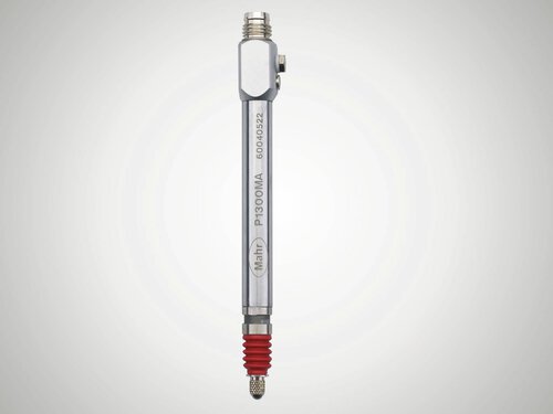

Inductive probe Millimar P1300 MA without cable
Product number: | 4400182 |
Compatibility: Mahr half-bridge
Measuring range : ± 2 mm
Vacuum lifter (standard option)
Package contains: test certificate, instruction manual, spanner for preliminary stroke setting, hose connector for compressed air
332,00 €
- Mahr compatibility
- Proven Mahr half-bridge technology
- Very easy to service: cables and probes can be separated via the plug-in connector
- Easy to convert to pneumatic lifting
Scope of delivery
Millimar P1300 MA without cable | Art. no. 4400182
a 85.6 mm | b 53.3 mm | c 98.6 mm | d 125 mm |
