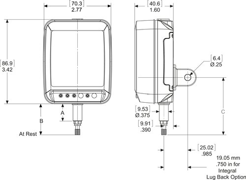

Millimess Maxµm III | Art. no. 2033125
a 17 mm | b 36 mm | c 63.5 mm |
