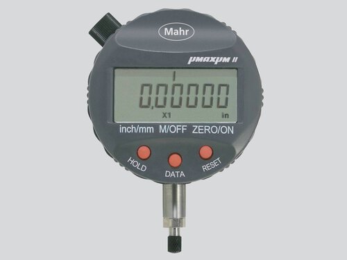

Inductive digital comparator Millimess µMaxµm II
Product number: 2034205
IP protection category: IP 54
Data interface: Digimatic, Opto RS-232C, USB
Data output Maxµm:
Factory standard

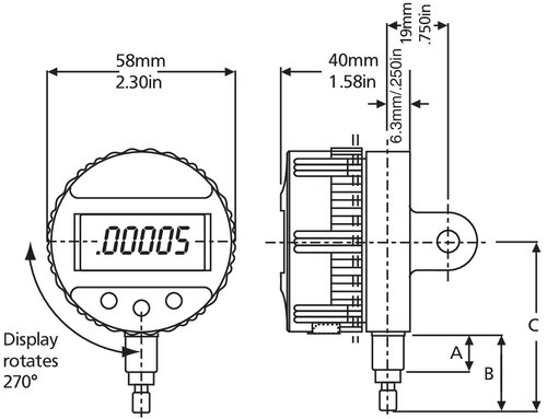

Measuring span : ±1 mm
Resolution: 0.0002, 0.0005, 0.001, 0.002, 0.005, 0.01, 0.02
Resolution inches: .00001", .00002", .00005", .0001", .0002", .0005", .001"
Mounting shaft : 8 mm x 11.7 mm
Package contains: instruction manual, battery

Functions ON/OFF, RESET (set display to zero), mm/inch, Reversal of counting direction, ABS (display can be set to zero without losing reference to preset), MAX/MIN memory for searching the reversal point, (MAX-MIN) for testing flatness and concentricity, Factor (Multiplier for measuring travel), HOLD (freeze current measured value)
Application For static and dynamic measurements
  • Inductive absolute measuring system
  • Large, high contrast display with numerical and scale display
  • Control and display unit rotatable through 270°
  • Zero point setting is retained even after switching off the dial indicator
Optional Factory Configured Features:
  • Locked multiplier factor for ratio measurements
  • Disabled sleep mode (manual ON/OFF)
  • Locked inch or mm display unit
  • Power up in inch or mm unit on battery change
  • Calibration mode lockout (with password entry)
  • Setup mode lockout (with password entry)
Energy supply battery operation
Scope of delivery instruction manual, battery
