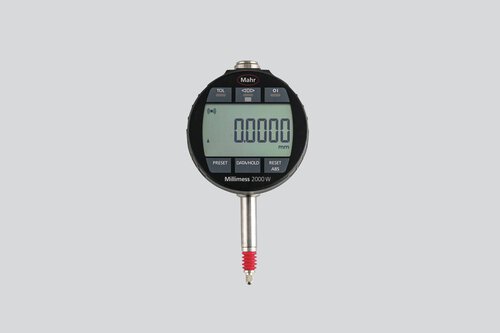

Inductive dial comparator Millimess 2001 W
| Product number: | 4346800KAL |
IP protection category: IP 64
Factory standard
Measuring span : ± 1 mm
Resolution: 0.0001, 0.0002, 0.0005, 0.001, 0.002, 0.005, 0.01
Resolution inches: .000005", .00001", .00002", .00005", .0001", .0002", .0005"
Supply voltage: 100-240 V
Package contains: USB data and charging cable type DK-U1, Plug-in power supply (with 4 interchangeable adapters) for USB, rubber bellows, Screwdriver for pre-stroke adjustment (hexagon socket 0.9 mm), test certificate, instruction manual, carton
Factory standard
678,00 €
Functions
ON/OFF, mm/inch, RESET (set display to zero), PRESET (for entering a numerical value), ABS (reference to the electrical zero point), Resolution selectable, TOL (Tolerance and Warning Limits Input), RANGE (switch the measuring range and resolution), MAX/MIN memory for searching the reversal point, (MAX-MIN) for testing flatness and concentricity, 0 (set the analog scale display to zero), Factor (Multiplier for measuring travel), Reversal of counting direction, HOLD (freeze current measured value), LOCK function (key lock), DATA (data transmission), Bi-directional data interface (for data retrieval - transfer of parameters - remote control - individual function locks via MarCom software)
For static and dynamic measuring tasks
- improved safety of measurement values in measuring stands, as only a light touch of the key - no keystroke - is required, thus no adjustment or deformation of the measuring device - Clear tolerance limits in the scale display and colored LED signals (red, green, yellow) for measured value classification
- with warning limit input: No Go / Go / Warning Limit
- without warning limit input: No Go / Go / Rework - LED signals (red, green, yellow) in mode:
- powered by Accumulator: flashing signal
- Analog scale display for visual recognition of the measuring movement during dynamic measurment tasks
- Measuring spindle is mounted in a high precision ball guide for minimal hysteresis
- Linearized inductive absolute measuring system
- Measuring force spring is interchangeable
- Lower stop is adjustable
Energy supply
Integrated rechargeable accumulator (up to 4 weeks) or powered by USB Data Cable
Package contains
Millimess 2001 W | Art. no. 4346800KAL
