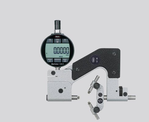

Indicating thread snap gage Marameter 853
| Product number: | 4511001 |
Measuring range : 35 - 75 mm
Package contains: flat contact point 903 (steel), wooden case, excludes indicator
1.595,00 €
- For pitch, root and outside diameters on taps in conjunction with interchangeable anvils
- Universally applicable and extremely versatile; each instrument spans a broad measuring range
- Rugged, forged steel frame with heat insulators
- Measuring spindle is mounted in long guideway with lever controlled retraction
- Anvil spindle adjustable with thumbscrew via worm and rack, for mounting interchangeable support yokes
- Measuring spindle and anvil are made of hardened stainless steel with mounting bore for insertion of interchangeable anvils
- Anvil spindle can easily be fine adjusted
- Maximum wear resistance due to non-contact positioning
Package contains
Marameter 853 | Art. no. 4511001
a 11.5 mm | b 192 mm | c 110 mm | e 65 mm | f 125 mm | g 14 mm | h 14 mm | n 8 mm |
