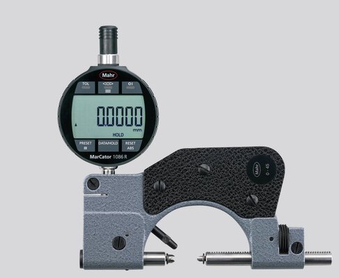

Indicating thread snap gage Marameter 852
| Product number: | 4510001KAL |
Measuring range : mm
Package contains: flat contact point 903 (steel), wooden case, excludes indicator
1.480,75 €
- For measuring pitch, root and outside diameters of all kinds of external threads as well as serrations
- Universally applicable and extremely versatile; each instrument spans a broad measuring range
- Rugged, forged steel frame with heat insulators
- Measuring spindle is mounted in long guideway with lever controlled retraction
- Measuring spindle and anvil are made of hardened stainless steel with mounting bore for insertion of interchangeable anvils
- Adjustable center stop for automatic alignment
- Anvil spindle can easily be fine adjusted
- Maximum wear resistance due to non-contact positioning in conjunction with carbide tipped measuring faces
Package contains
Marameter 852 | Art. no. 4510001KAL
a 8 mm | b 193 mm | c 11 mm | e 60 mm | f 103 mm | g 14 mm | h 13 mm | k 28 mm | l 59 mm |
