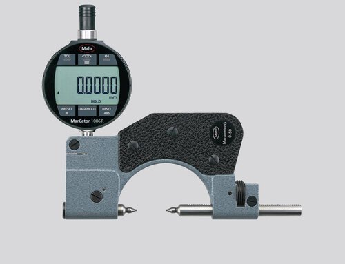

Indicating snap gage Marameter 840 FG
| Product number: | 4454000 |
Measuring range : mm
Package contains: flat contact point 903 (steel), wooden case, excludes indicator
1.405,00 €
- For cylindrical parts such as shafts, bolts and spindles
- Universally applicable
- A wide variety of measurement problems can be solved with the broad range of interchangeable anvils
- Rugged, forged steel frame with heat insulators
- Measuring spindle is mounted in long guideway with lever controlled retraction
- Measuring spindle and anvil spindle have an M 2.5 connection thread, thus enabling the use of interchangeable anvils that are also used in dial indicators and dial comparators
- Anvil spindle can easily be fine adjusted
- Maximum wear resistance due to non-contact positioning in conjunction with carbide tipped measuring faces
Package contains
Marameter 840 FG | Art. no. 4454000
a 5 mm | b 140 mm | c 68 mm | d 9 mm | e 60 mm | f 77 mm | g 13 mm | h 13 mm | k 25 mm | l 34 mm | n 2 mm |
