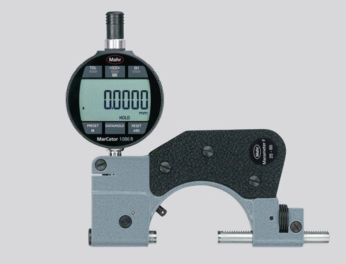

Indicating snap gage Marameter 840 FC
Product number: | 4450100KAL |
Measuring range : mm
Material Contact surface: ceramic
Package contains: flat contact point 903 (steel), instruction manual, wooden case, excludes indicator
1.339,25 €
- For cylindrical parts such as shafts, bolts and spindles
- For thickness and length measurements
- Universally applicable and extremely versatile
- Each instrument spans a broad measuring range
- Any dimension and fit can be very quickly and easily adjusted
- Rugged, forged steel frame with heat insulators
- Measuring spindle is mounted in long guideway with lever controlled retraction
- Measuring spindle and anvil spindle are both made of hardened stainless steel, ceramic measuring faces
- Adjustable centering stop for surface centering
- Anvil spindle can easily be fine adjusted
- Maximum wear resistance due to non-contact positioning in conjunction with carbide tipped measuring faces in connection with ceramic measuring faces
ceramic
Package contains
Marameter 840 FC | Art. no. 4450100KAL
a 5 mm | b 97 mm | c 34 mm | d 8 mm | e 54 mm | f 65 mm | g 12 mm | h 13 mm | k 23 mm | l 14 mm |
