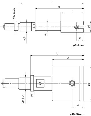

Model for through holes, measuring surfaces diamant-tipped
Preferred application on very sensitive surfaces of soft non-ferrous metals and aluminium alloys
- With extended guide cylinder for measuring through holes from the edge of the hole
- For rapid testing of diameter, roundness and conicity of bores
- Especially suitable for testing batches with tight tolerance zones
- Rocking in the bore is not required to determine diameter
- Ideal for use in conjunction with digital display units and for subsequent processing of measured values
- Measuring probe made of hardened, stainless guide cylinder and diamond-tipped probes
- Carbide driving needle transfers radial measuring movement to the display unit
- Constant measuring force thanks to inbuilt measuring force spring. Measuring results are therefore independent of personal sense of touch
- Measuring head, measuring instrument holder, depth extensions, right-angle attachments and depth stops form a comprehensive modular system

Marameter 844 DR-D | Art. no. 4484338
a 17.9 mm | b 44.8 mm | c 33 mm | e 10 mm |
