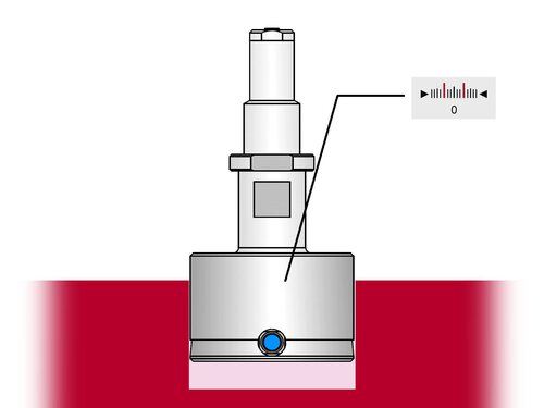

Application Standard version for very tight tolerance fields less than 10 µm
Manufacturing tolerance of the guide cylinder reduced to 0.01 mm (±5 µm) to reduce the axial and radial measuring influences
  • For the rapid testing of diameter, roundness and conicity of bores
  • Ideal for testing batches with very tight tolerance fields less than 10 µm
  • Rocking in the bore is not required to determine diameter
  • Therefore ideal for use in conjunction with digital display units and for subsequent processing of measured values
  • Measuring head has a hard, stainless cylinder guide and carbide-tipped anvils
  • The carbide expanding pin transfers radial movement to indicating instrument
  • Constant measuring force as a result of built-in spring, eliminating user influence
  • Extensive modular system is composed of measuring head, holder, depth extension, right angle attachments and depth stops
