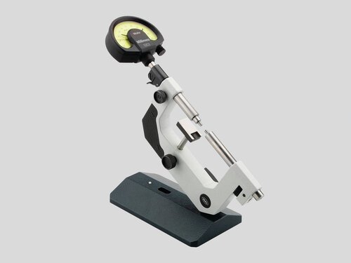

Indicating bench snap gage Marameter 852 TS
Product number: 4510030

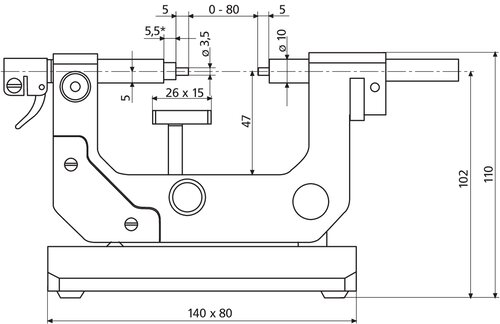

Measuring range : mm
Package contains: plan carbide anvils Dia. 3,5 mm
1.445,00 €
Variants
5,60 €
Please enter the label
  • Perfect ergonomic design as base can be inclined ensuring it is easy to read and the operator has free hands
  • For rapid measurements of cylindrical parts (shafts, bolts and shanks)
  • Thickness and length measurements
  • For determining the pitch diameter of external threads (optionally with thread flank measuring anvils)
  • For gears (optionally with sphere or roller measuring anvils)
  • Particularly suited for exact series measurements
  • Rugged steel frame can be inclined up to 45° from the sturdy base
  • Measuring spindle and anvil are made of hardened stainless steel with mounting bore for insertion of interchangeable anvils
  • Height adjustable stop
  • Anvil spindle can easily be fine adjusted
  • Constant measuring force as a result of built-in spring, eliminating user influence
Package contains plan carbide anvils Dia. 3,5 mm
