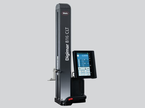

Height measuring instrument Digimar 816 CLT
| Product number: | 4429631 |
Measuring range : 0 - 600 mm
0.0001 mm, 0.0005 mm, 0.001 mm, 0.005 mm, 0.01 mm / 0.00001 inch, 0.00005 inch, 0.0001 inch, 0.0005 inch, 0.001 inch
Error limit µm: (1.8 + L/600) L in mm
Data interface: 3x USB 2.0, wireless
Package contains: height measuring instrument incl. operating and display unit, carrier 817h1, probe K6/51, setting block 817 eb, USB cable, instruction manual, power source, protection cover, Calibration certificate
6.150,00 €
Functions
Contacting from below/above, Bar width or groove spacing incl. bar or groove center, Bore or shaft diameter incl. bore or shaft center, Reversal point bores (top or bottom), Reversal point shaft (top or bottom), Calculate distances or symmetry, Dynamic measurement functions, Right angle measurement, Straightness measurement, Measurement in 1D mode, Measurement programs, Measurement data processing
Measuring system properties
- Excellent measuring accuracy and reliability due to optical incremental measuring system with double reading head
- Dynamic probe system for high repeatability
- Air bearing system for easy, jerk-free displacement
- Measuring head guided in precision ball bearings
- Simple measuring sequences due to motorized measuring slide
- Probe constant remains after switch-off
- Integrated rechargeable battery with high operating time for mains-independent measuring
- Temperature compensation via int. temperature sensor
Package contains
Digimar 816 CLT | Art. no. 4429631
a 89 mm | b 278 mm | c 77 mm | d 255 mm
