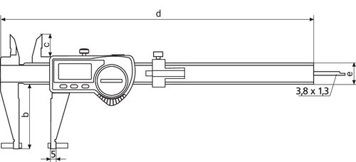

MarCal 16 EWR-V | Art. no. 4118807KAL
b 48 mm | c 16.5 mm | d 285 mm | e 16 mm |
