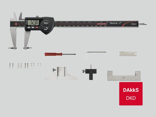

Digital universal caliper MarCal 16 EWR-V
Product number: | 4118807DKS |
Measuring range : 0 - 200 mm
Resolution mm/inch: 0.01 mm / 0.0005 inch
Depth rod: rectangular
IP protection category: IP 67
Package contains: setting gage for inside measurement 16 Eel, measuring force device 16 Ec, depth measuring bridge 16 Em, anvils for outside measurement 16 Eea 1-3, anvils for inside measurement 16Eei 1-3, 4118808 without measuring anvils, adjustment bridge and measuring force equipment, battery, test certificate, instruction manual, case
695,70 €
Functions
AUTO-ON / OFF, DATA (data transmission via connection cable), ON/OFF, PRESET (for entering a numerical value), RESET (set display to zero), mm/inch, LOCK function (key lock)
- Can be used as a standard caliper (four types of measurements) with standard accessories to measure recesses, grooves, etc.
- Can be used with additional accessories to measure threads, bores and serration
- High contrast digit display
- Locking screw above
- Lapped guideway
- Step measuring function
Scope of delivery
MarCal 16 EWR-V | Art. no. 4118807DKS
b 48 mm | c 16.5 mm | d 285 mm | e 16 mm |
