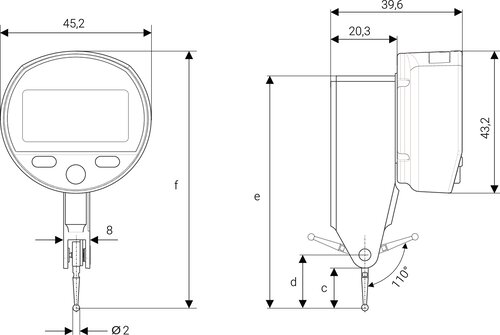

MarTest 800 EWR | Art. no. 4306130
c 14.2 mm | d 17.7 mm | e 72 mm | f 79.7 mm
