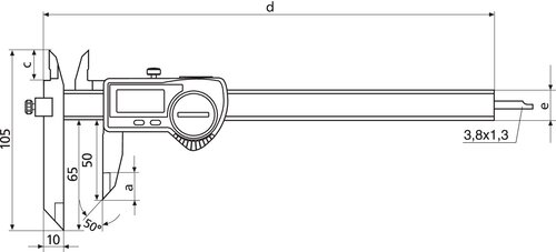

Digital special calipers MarCal 16 EWRi-VS
Product number: 4103383
Measuring range : 0 - 200 mm
IP protection category: IP 67
738,00 €
Variants
5,60 €
Please enter the label
Functions ON/OFF, AUTO-ON / OFF, mm/inch, LOCK function (key lock), RESET (set display to zero), PRESET (for entering a numerical value), DATA (data transmission), HOLD (freeze current measured value)
Application With moving jaws for measuring stepped workpieces
  • High contrast digit display
  • Locking screw above
  • Lapped guideway
  • Measuring blade for inside measurements
  • Slide and beam made of hardened stainless steel
  • Immediate measurements due to the Reference System
  • Raised guideway for the protection of the scale
  • Excellent resistance against dust, coolants and lubricants
  • Dirt wipers are integrated in the slide
Scope of delivery battery, test certificate, instruction manual, case
MarCal 16 EWRi-VS | Art. no. 4103383
