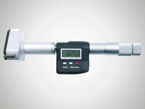

Digital inside micrometer Micromar 44 EWR
| Product number: | 4191126KAL |
For measuring:
IP protection category: IP 52
Data interface: Digimatic, Opto RS-232C, USB
DIN 863-4
Measuring range 25 - 30 mm mm
Package contains: basic units 44 EWg, measuring head 44 Ak, instruction manual, battery, case
For measuring:
- Through holes
- Blind holes
- Centering shoulders
DIN 863-4
1.440,10 €
Functions
RESET (set display to zero), ABS (display can be set to zero without losing reference to preset), mm/inch, PRESET (for entering a numerical value), DATA (data transmission via connection cable), LOCK function (key lock)
For measuring:
- Through holes
- Blind holes
- Threaded connection for changing the measuring head
- Self-centering measuring head consists of 3 anvils (offset 3 x 120°)
- Measuring anvils from 12 mm are carbide tipped
- From 12 mm measuring anvils for measurements up to the bottom of the bore
- From 40 mm measuring head housing made of anodized aluminium
Data interface
Package contains
Micromar 44 EWR | Art. no. 4191126KAL
b 9 mm | c 4 mm | d 68 mm |
