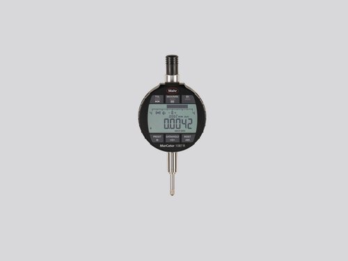

Digital indicator MarCator 1087 ZRi
Product number: | 4337970 |
IP protection category: IP 42
Factory standard
Measuring span : 12.5mm
Resolution inches:
Factory standard
Resolution inches:
609,00 €
Functions
ON/OFF, mm/inch, RESET (set display to zero), 0 (set the analog scale display to zero), PRESET (dimension presetting) - 3 values possible, MAX/MIN memory for searching the reversal point, (MAX-MIN) for testing flatness and concentricity, Analog scale (display with pointer or as a bargraph), TOL (Tolerance and warning limit setting) - 3 tolerances possible, ABS (display can be set to zero without losing reference to preset), Factor (Multiplier for measuring travel), Reversal of counting direction, Resolution selectable, LOCK function (general key lock in the menu and individual key and menu locks for process-safe measurements via MarCom software), Bi-directional data interface (for data retrieval - transfer of parameters - remote control - individual function locks via MarCom software), Remote-controllable by MarCom software, DATA (data transmission), HOLD (freeze current measured value)
Comprehensive measuring functions for:
- improved safety of measurement values in measuring stands, as only a light touch of the key - no keystroke - is required, thus no adjustment or deformation of the measuring device - Analog scale display for visual recognition of the measuring movement during dynamic measurment tasks
- Clear tolerance limits in the scale display and colored LED signals (red, green, yellow) for measured value classification
Package contains
MarCator 1087 ZRi | Art. no. 4337970
