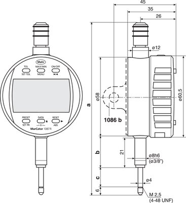

Digital indicator MarCator 1087 Ri
Product number: | 4337665 |
IP protection category: IP 42
Data interface: Integrated Wireless, USB, Digimatic, Opto RS-232C
Factory standard
Measuring span : 25mm
Factory standard
690,00 €
Functions
0 (set the analog scale display to zero), ABS (display can be set to zero without losing reference to preset), AUTO-ON / OFF, DATA (data transmission), Factor (Multiplier for measuring travel), LOCK (individual key lock), MAX/MIN memory for searching the reversal point, ON/OFF, PRESET (for entering a numerical value), RANGE (switch the measuring range and resolution), RESET (set display to zero), (MAX-MIN) for testing flatness and concentricity, TOL (enter tolerance limit values), Reversal of counting direction, mm/inch
Comprehensive measuring functions for:
- Integrated wireless transmitter
- High-contrast LCD display
- Lifter protection cap on the measuring spindle
- Clamping shaft and measuring pin made of hardened stainless steel
Energy supply
Battery life approx. 3 years (approx. 0.5 in wireless mode)
Scope of delivery
MarCator 1087 Ri | Art. no. 4337665
a 153.4 mm | b 26.8 mm | c 26.5 mm |
