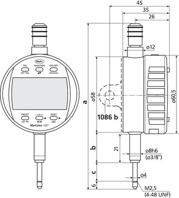

Digital indicator MarCator 1087 R
| Product number: | 4337661 |
IP protection category: IP 42
Data interface: Opto RS-232C, Digimatic, USB
Factory standard
Measuring span : 25mm
Factory standard
648,00 €
Functions
ON/OFF, RESET (set display to zero), mm/inch, Reversal of counting direction, PRESET (for entering a numerical value), TOL (enter tolerance limit values), MAX/MIN memory for searching the reversal point, (MAX-MIN) for testing flatness and concentricity, ABS (display can be set to zero without losing reference to preset), DATA (data transmission via connection cable), Factor (Multiplier for measuring travel), LOCK (individual key lock)
Comprehensive measuring functions for:
- High contrast LCD display, thus very clear and safe to read
- Lifter protection cap on the measuring spindle
Energy supply
Battery life approx. 3 years
Package contains
MarCator 1087 R | Art. no. 4337661
a 153.4 mm | b 26.8 mm | c 26.5 mm |
