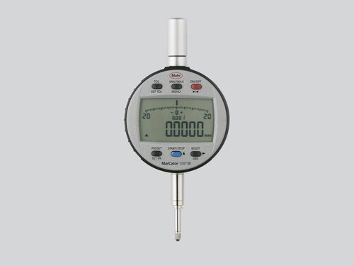

Digital indicator MarCator 1087 BRi
Product number: 4337664
IP protection category: IP 42
Data interface: Integrated Wireless, USB, Digimatic, Opto RS-232C
Factory standard
Measuring span : 12.5mm
702,00 €
Variants
6,00 €
Please enter the label
Functions ON/OFF, RESET (set display to zero), mm/inch, PRESET (for entering a numerical value), Reversal of counting direction, TOL (enter tolerance limit values), START/STOP search for reversal point, MAX/MIN memory for searching the reversal point, ABS (display can be set to zero without losing reference to preset), 0 (set the analog scale display to zero), DATA (data transmission), Factor (Multiplier for measuring travel), LOCK (individual key lock)

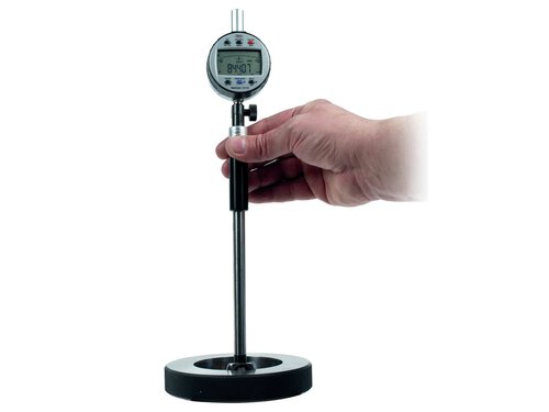

Application In measurements with a 2-point bore gage the reversing point can be calculated automatically during oscillation. Then a PRESET value can be assigned.
The ACTUAL value measured is saved by the MIN or MAX function and is shown on the display.
The 1087 BRi model can process 64 measured values per second, for fast measuring movements combined with measuring certainty.
  • Integrated wireless transmitter
  • High-contrast LCD display
  • Operating and display unit (bezel) can be rotated through 280°
  • Lifter protection cap on the measuring spindle
  • Clamping shaft and measuring pin made of hardened stainless steel
  • Immediate measurements due to the Reference System
Energy supply Battery life approx. 3 years (approx. 0.5 in wireless mode)
Package contains battery, test certificate, instruction manual, carton
MarCator 1087 BRi | Art. no. 4337664
