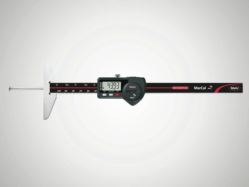

Digital depth gage MarCal 30 EWR-N
Product number: 4126513
Measuring range : 0 - 100 mm
Resolution mm/inch: 0.01 mm / 0.0005 inch
IP protection category: IP 67
Package contains: battery, test certificate, instruction manual, anvils 30 Ent (1mm), 902 (4mm) and 903 (4mm), case

Functions ON/OFF, AUTO-ON / OFF, mm/inch, LOCK function (key lock), RESET (set display to zero), PRESET (for entering a numerical value), DATA (data transmission via connection cable)
Application Measuring groove widths and distances between grooves
  • High contrast digit display
  • Locking screw above
  • Lapped guideway
  • Measuring surfaces made of steel
  • Slide and beam made of hardened stainless steel
  • Immediate measurements due to the Reference System
  • Raised guideway for the protection of the scale
  • Excellent resistance against dust, coolants and lubricants
  • Dirt wipers are integrated in the slide
Scope of delivery battery, test certificate, instruction manual, anvils 30 Ent (1mm), 902 (4mm) and 903 (4mm), case
