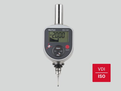

Digital 3D touch probe MarTest 802 EW
Product number: | 4304300KAL |
Working areas, X-, Y-, Z-axis: -2 to 4 mm
Resolution_mm: 0,005
Package contains: battery, instruction manual, stylus 802 EWt
751,00 €
Functions
ON/OFF, Auto OFF after 2 hours
Can be used on milling and CNC machines to
- determine the zero position on workpieces
- determine the center of bores
- determine and correct the alignment of a workpiece
and for the measurement of
- lengths
- depths
Excellent readability thanks to combined display:
- bar graph for dynamic path information
- digital display for exact readings
- Can be controlled independently of a machine tool
- Large working range in all axes (X, Y, Z) prevents damage to the stylus by contacting errors
- Compact metal housing and long probe arm
- Shockproof movement
Package contains
