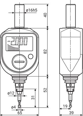

Working areas, X-, Y-, Z-axis: -2 to 4 mm
Resolution: 0.005

ON/OFF, Auto OFF after 2 hours
Use in milling and eroding machines to
- determine the zero position on workpieces
- determine the center of bores
- determine and correct the alignment of a workpiece
and for the measurement with defined measuring force (by moving the machine tool axes in X/Y and Z) of
- lengths
- widths
- distances
- depths
Excellent readability thanks to combined display:
- bar graph for dynamic path information
- digital display for exact readings
- Can be controlled independently of a machine tool
- Large working range in all axes (X, Y, Z) prevents damage to the stylus by contacting errors
- Compact metal housing and long probe arm
- Shockproof movement
