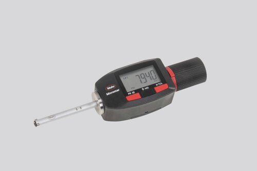

Functions
RESET (set display to zero), ABS (display can be set to zero without losing reference to preset), mm/inch, PRESET (dimension presetting) - 3 values possible, TOL (Tolerance and warning limit setting) - 3 tolerances possible, LOCK function (key lock), HOLD (freeze current measured value), DATA (data transmission), Bi-directional data interface (for data retrieval - transfer of parameters - remote control - individual function locks via MarCom software)
For measuring of:
- Through holes
- Blind holes
- Uniquely user-friendly with practical functions
- Optimal handling due to lightweight and compact basic unit
- Large, high-contrast numerical display with clear tolerance icons
- Self-centering measuring head consists of 3 anvils (offset 3 x 120°)
- Measuring anvils from 12 mm are carbide tipped
- From 12 mm measuring anvils for measurements up to the bottom of the bore
- From 40 mm measuring head housing made of anodized aluminium
Energy supply
Battery, battery life up to 4 years (approx 10000 hrs without wireless transmission)
Data interface
Integrated Wireless
Package contains
Basic unit 44 EWRi-g, measuring head 44 Ak, instruction manual, battery, case
Micromar 44 EWRi | Art. no. 4191305
a 1.5 mm | b 4 mm | c 1.5 mm | d 58 mm |
