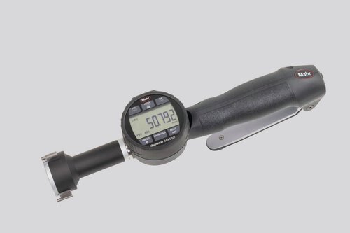

Digital 3-point inside measuring instrument Micromar 844 EWRi

Functions
RESET (set display to zero), ABS (display can be set to zero without losing reference to preset), mm/inch, PRESET (dimension presetting) - 3 values possible, TOL (Tolerance and warning limit setting) - 3 tolerances possible, LOCK function (key lock), HOLD (freeze current measured value), DATA (data transmission), Bi-directional data interface (for data retrieval - transfer of parameters - remote control - individual function locks via MarCom software)
Fast measurements by lever retraction (covers the complete application range of the respective measuring head) from:
- through holes
- blind holes
- Outstanding handling thanks to ergonomically shaped pistol grip
- Reliable reading of measured values on the large, high-contrast and rotating display
- Best performance: 2 data keys integrated in the lever for optimum handling in all measuring directions
- Threaded connection for changing the measuring head
- Self-centering measuring head consists of 3 anvils (offset 3 x 120°)
- Measuring anvils from 12 mm are carbide tipped
- From 12 mm measuring anvils for measurements up to the bottom of the bore
- From 40 mm measuring head housing made of anodized aluminium
