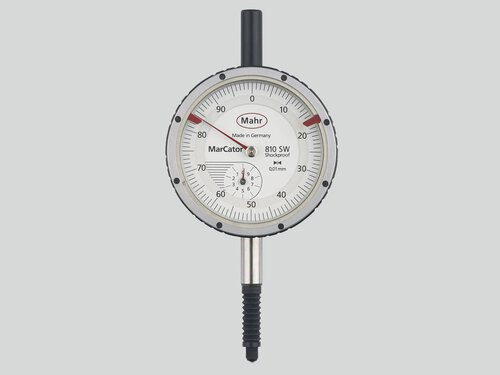

Dial indicator with IP protection MarCator 810 SW
Product number: | 4315000 |
IP protection category: IP 54
DIN 878
Measuring span : 10mm
Readings: 0.01
Package contains: case
DIN 878
Readings: 0.01
112,50 €
- Special design with IP protection against liquids and dust
- Ideal for use in particularly challenging environments where the dial gauge is highly contaminated or exposed to splash water
- High contrast dial face
- Chrome plated housing
- Precision gears and pinions
- Hermetically sealed upper protective measuring spindle cap, bezel and transparent dial cover; sealed with O-rings
- Measuring spindle sealed with rubber sleeve, thus preventing contamination by liquids and impurities

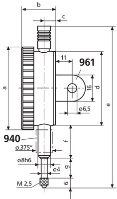

a 61 mm | b 24.2 mm | c 7.9 mm | d 52 mm | e 127.6 mm | f 22 mm | g 22.1 mm
