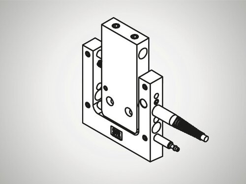

The measuring modules wtih integrated lifting simplify the set up of (measuring concepts in the)
multi-gaging metrology unit.
The construction of the modules allows for the differential recording of length changes
(e.g. outside diameters) with only one electronic probe.
The correct measuring force is attained through adjustable measuirng force springs suited to the
purpose and function of the unit.
The lifitng of the moveable elements is enabled by pneumatic microcylinders integrated in the
module of the body.
specially developed for industrial use, the modules use non-corrosive material and simplifiy
advance technics that garantee precision and reliability (of the measurement).
- A rotary stroke bearing and anti-twist guard
- Total stroke 10 mm
- Measuring force: 30 to 250 gr
- Repeatability: 0.5 ?m
- with P2004 probe
