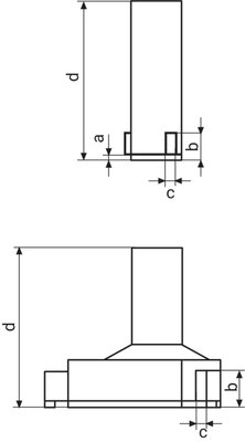

  • Self-centering measuring head consists of 3 anvils (offset 3 x 120°)
  • Measuring anvils from 12 mm are carbide tipped
  • From 12 mm measuring anvils for measurements up to the bottom of the bore
  • From 40 mm measuring head housing made of anodized aluminium
