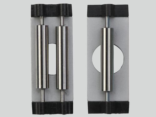

Thread pin gages, holder pair MarGage 426 M
| Product number: | 4820045KAL |
426 M Thread pin gages, holder pair
Diameter : 2.05
Mounting hole: 8
Diameter : 2.05
Mounting hole: 8
223,40 €
- For determining the pitch diameter of external threads by the three-wire method
- In conjunction with outside micrometers, indicating measuring instruments or measuring machines
- Each pair consists of one holder with 1 pin gage and one holder with 2 pin gages
- Holder has a satin chrome finish, the retainer ring can be locked yet the rotating spindle can still rotate
- Pin gages are hardened and lapped. Freely floating in holder to allow proper positioning and contact with thread flanks
- Manufacturing tolerance ± 0.5 ?m
- Mounting bore 6.35 mm = 1/4", 8 mm on request)
- For threads with outer diameter up to 95 mm
MarGage 426 M | Art. no. 4820045KAL
