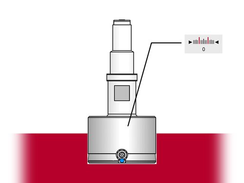

Model for blind holes, for very tight tolerance fields less than 10 µm
Manufacturing tolerance of the guide cylinder reduced to 0.01 mm (±5 µm) to reduce the axial and radial measuring influences
- For measurements close to the base of the hole
- For the rapid testing of diameter, roundness and conicity of bores
- Ideal for testing batches with very tight tolerance fields less than 10 µm
- Rocking in the bore is not required to determine diameter
- Therefore ideal for use in conjunction with digital display units and for subsequent processing of measured values
- Measuring head has a hard, stainless cylinder guide and carbide-tipped anvils
- The carbide expanding pin transfers radial movement to indicating instrument
- Extensive modular system is composed of measuring head, holder, depth extension, right angle attachments and depth stops
