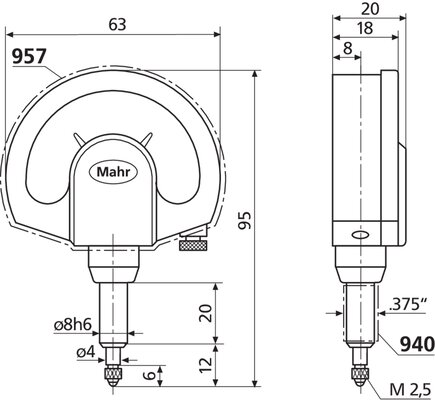

Mechanical dial comparator Millimess 1010
Product number: | 4332000 |
Dial comparator Millimess 1010
Factory standard
Measuring range : ± 0.25 mm
Readings: 0.01
Package contains: test certificate, case
Factory standard
Readings: 0.01
187,00 €
- Large, high contrast dial face
- Lockable fine adjustment screw
- Shockproof movement
- Measuring spindle is mounted in a high precision ball guide for minimal hysteresis
- Resistant to lateral forces (side play) acting on the measuring spindle
- Maximum sensitivity and accuracy are ensured by the jeweled movement in conjunction with the precision gears and pinions
- Box type protective housing
- Constant measuring force
- Measuring spindle can be retracted with either a screw in cable release or with a lifting knob
